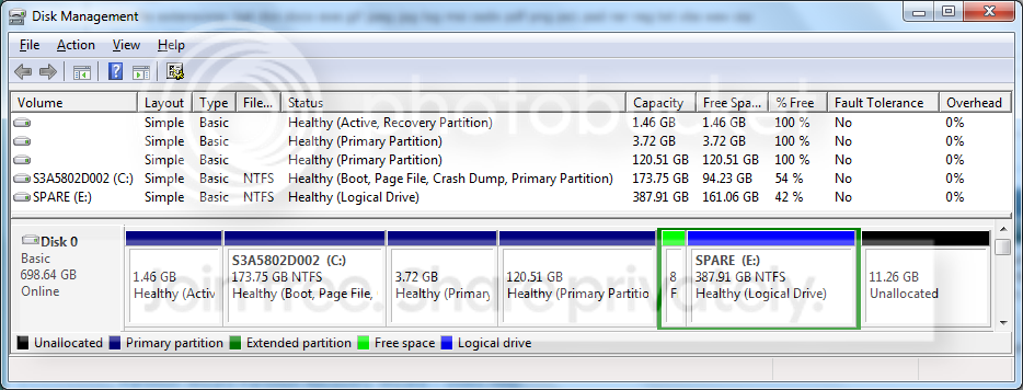

I was installing Ubuntu as a dual boot, and wanted to install it on its own partition. But I already had 4 primary partitions (the 1.46GB bootable recovery partition, C:, E: and the 11.26GB partition with the recovery files). So i shrunk C:, deleted the 11.26GB partiton and created the new primary partition. I later discovered it had the recovery files.
Ubuntu installation needed some other partitions and it must've converted E: to a logical drive.

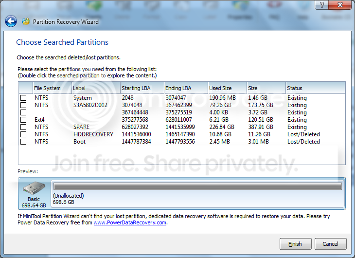

The results of a full quick scan:

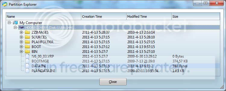

Double clicking the HHDRECOVERY partition (unallocated space) shows the recovery files:
However, doing a full scan of the unallocated space also shows a small partition labeled "Boot":

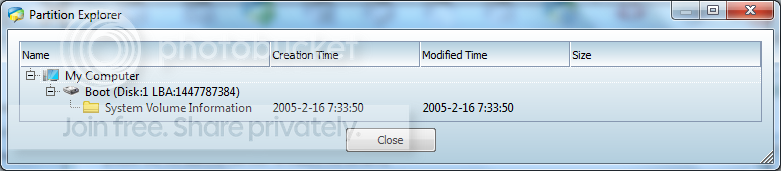

Double clicking that drive shows the following:
However, that folder does not appear to contain any files. There was a [+] to the left of the folder, but clicking it just made it disappear since there was nothing to show. I'm not sure if I can just ignore this tiny section or not.
I am just wondering if anyone has any recommendations on how I should proceed. I have not ever attempted partition recovery or used this program before and feel like I only have one shot at this and don't want to screw it up, if it is even possible.

It wasnt originally such a mess. Originally there was only the 1.46GB and 11.26GB recovery partitions, C:, and E: which i used for storage. Ubuntu wanted a SWAP partition so I gave it one. The 8MB free space is due to installation of Ubuntu.

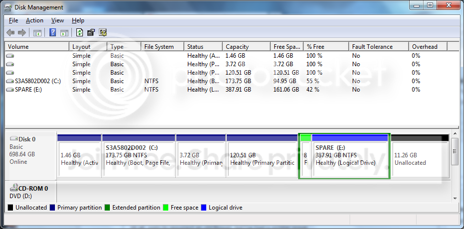

Here is maximized disk manager:

If you want to keep what you've got you can resize C into any of the other adjacent partitions since there seems to be no content on them until the Logical, and/or create new partitions in all or part of the space.
These systems with no System partition always bother me because if the System boot files are correctly written to the Active partition then there should be a System flag signifying this. We have to assume the System boot files are on the 1.46 Active partition, so before deleting it I'd move System boot files to C by marking C Active then running Startup Repair - Run 3 Separate Times until it is marked System Active.
None of this will restore the hotlink to Recovery Partition although it might still be intact once you restore it - you can test it to see.
You can use free Partition Wizard bootable CD to mark Active, Rebuild MBR, delete, resize as you wish. Partition Wizard Move/Resize Partition - Video Help.
I've never seen PW CD fail to restore a lost partition so it should also be able to put it back into the Unallocated space.

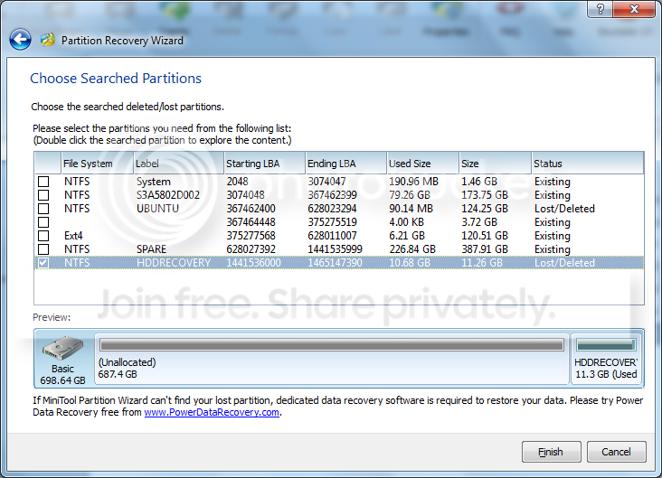

Using the partition manager I unhid the HDDRECOVERY partition.
Attempting to access the recovery by holding the zero key upon booting resulted the partition failing to properly boot before windows started to load.
Reinstating the partition as hidden allowed the recovery partition to properly boot.
Using the partition manager I deleted the recovery partition and applied changes. I then used the partition recovery wizard to restore the partition. At this point the partition was not hidden. It was successfully hidden. I was then able to successfully boot into the recovery partition.
