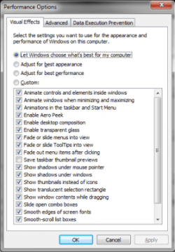

Toogle (where is Start, time and shorcuts) is not transparent(I can`t set up theme pic1). Also the graphic design in pic2 is not like in Aero. And there is one more problem. The symbols of turning up/down volume or brightness are missing. Casp/numlock symbols work.

Also i tried change "Performance Options" / pic3
