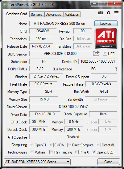

Here are the results from GPU-Z with the new driver version 8.593:
