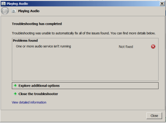

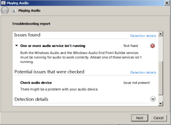

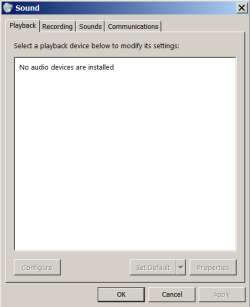

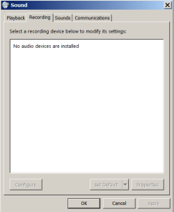

Hello everyone,I'm facing a particular issue with audio on my computer.Essentially, all audio functionality has ceased. This means that none of the audio services are operational, and the 'Audioserv' has vanished from the list of services. Attempting to initiate the Endpoint Builder service results in an error. Moreover, when I access the sound settings by right-clicking the volume icon on the taskbar, the interface appears devoid of any internal data, displaying neither playback nor recording devices.I've sought assistance from various sources, which typically advise using the troubleshooter, starting certain services, and verifying administrative privileges, among other suggestions. Despite reviewing over 15 YouTube tutorials and consulting 35 websites, the issue persists, leading me to seek guidance from this forum in hopes of further assistance.Ideally, I would prefer a default registry file that could reset all services to their default configurations with a simple double-click. However, I am uncertain of its feasibility. While numerous websites outline the default settings for all services, manually adjusting each one is impractical.
I thank you in advance for all help and assistance given.
daa65
- - - Updated - - -

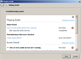

Some screenshots to help understand matters better.

Hi
i take it your running a desktop, so how are your audio devices attached, if your routing it thru the Asmedia hub looks like the driver has a problem
Axiom speakers?? whats showing in the dashboard monitor
check the for the latest drivers

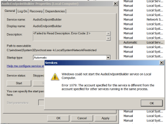

Many of my services gave me this dialogue when I tried to set them to either Automatic or Manual; both gave me the same pop-up. This made me think that something important had been added to my system as a whole, and I need someone to help me figure out what it might be. I was looking through the list of services to switch between Automatic and Manual.Thank you all in advance for your assistance.
​View attachment 424388

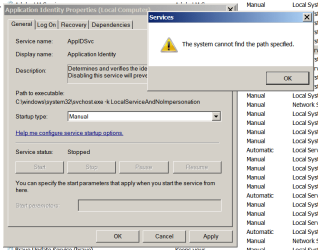

A lot of these services give me the same error# type?
​View attachment 424389

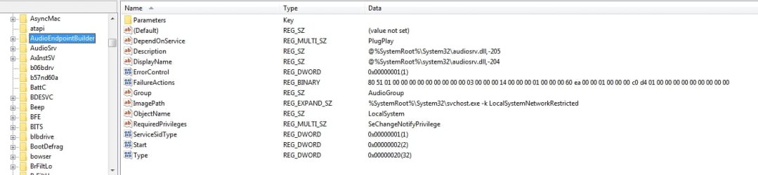

what has happened to your audio endpointbuider and the service log on should be local service for windows audio
do you have a restore point or a backup image to a time before the problem started ?
If not, then you could try a repair install

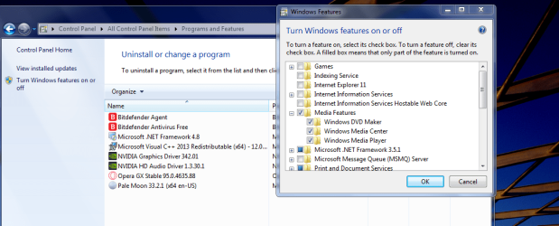

Hi
that missing path is "spawned" from the Windows Media Features option
via
Programs/Features >> Turn features on/off (top left) >> Media Features (enable all 3 components)
likely require a reboot
I looked over your services settings and there pretty much the same as mine....so no worries there
do you have a restore point or a backup image to a time before the problem started ?If not, then you could try a repair install
Thank you for your help. I have just changed that to Local Services now.
Hope it all works, haven't seen any change as yet? Maybe a restart..

Hi
via
likely require a reboot.

Also not sure why this AudioEndpoint Service won't startup anymore?
Anybody? Any clues, please?

features
well here we are, the instructions were specific
SIW2 those entries are "hiding" in the background and will not be initilised until the WMP options are enabled

All my features show ON!?
- - - Updated - - -
- - - Updated - - -
Please tell me what you are trying to say with this?
What needs to be done and how I go about doing it are both unclear to me.
Are you proposing to make the following registry edit?
Whatever the case, thank you for your assistance. Thank you.

you can try.
copy and paste what is in the code tags using notepad and save it as a .reg file call it anything you like, for example
audioendpoint.reg
then double click on it to merge it into your registry. Or rt click it and select merge

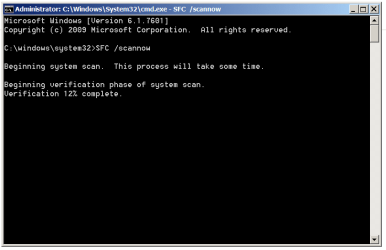

if SIW2 instructions fail,

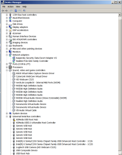

1) DID you update the Asmedia root hub driver problem
2) run sfc /scannow
3) run KB947821

you can try.
audioendpoint.reg
I will give that a try. Thanks for the assistance.

Re the Asmedia root hub problem, yellow exclamation mark in the device manager screenshot first postw

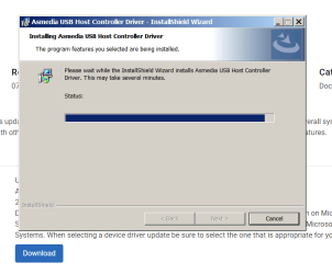

Installing it now...
Daa
- - - Updated - - -
Now installed, but still getting the no Audio Services, etc...

2) run sfc /scannow < Now, I have to run this. Got that.
3) run KB947821 < how do I engage this though?

Scan on the way...
Daa
- - - Updated - - -
Scan complete... No #errors found.

I got the.reg to work and merged the settings to my registry thanks to your how-to link, but haven't got audio devices as yet?
- - - Updated - - -
Hey! Guess what... all your help has paid off. Merging the .reg file has done the trick.
:thumbsup:
I want to express my gratitude to SIW2 and Torchwood for their assistance in resolving this annoying pesky audio problem.
To the both of you, your help was much appreciated. For that, I am really grateful. Yes, indeed.
Thank you, SIW2 and Torchwood.
All Audio Services are back online and showing. 👍
