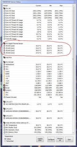

3. Install HWINFO64 and run the SENSOR-ONLY bit from the splash screen - you should see a panel displaying key temperatures:

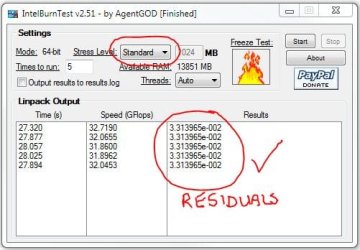

4. Run 3 IntelBurnTest stress tests using these settings:
- Standard
- High
- Very High
IMPORTANT : you MUST monitor your temperatures during these test. You want to carefully observe the CPU Digital Thermal Sensor temperatures as shown above. Your CPU has a maximum TCase temperature of 72.6 degress C - please confirm that with link below. Usually we add 5 degrees to that. So, if your CPU starts approaching 77.6 degrees C, immediately stop the tests.
Intel® Core
If your CPU passes the stress tests, then all 5 residual values, as ringed in red above, will be the same:
Let us know how you get on. Remember that stress-testing stresses the system - you do so entirely at your own risk.

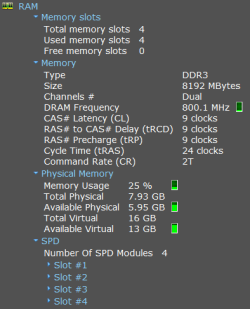

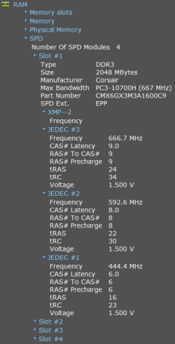

Just looking at your memory. Check you bios to see if you have it running in profile XMP. It should be running at 1600 Mz. Very simple way to clock the memory. If it is then it is just the way it is being shown in the above program.

Just saw that the memory you have listed in your specs & the memory posted above are different so check that first.

thanx for the reply. ive been using realtemp and prime95 and as far as i can tell it seems fine. doesnt flicker or shutdown. only slows the computer down while the test runs. the memory is set in the bios 1600MHz and when the pc starts it says 1600MHz on the 1st screen. but ineverything else its says 800.0 MHz. not sure whats wrong there
DDR = Double Data Rate 800*2=1600mhz
It's being reported correctly. It's all good mate :)
