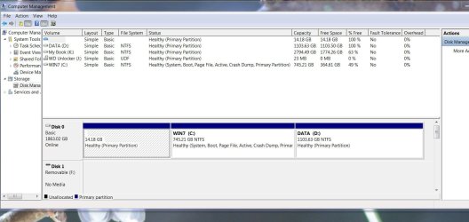

Please post back a screenshot of Disk Management - Post a Screen Capture Image so we can look over your disk configuration.

gregrocker - Here is the snapshot of my Disk Management system:
