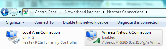

Notice: I windows recognizes the adapter:
But it doesn't give any wireless conection options:

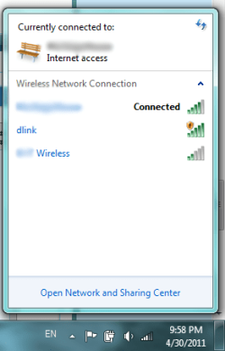

UPDATE: So I tried using the HP Support Assistant (that's the HP program on my computer that supposed to tell me my model number) again and was mucking around in there when I came to "Troubleshoot Network and Internet Connectivity" all it did was examine my network options (I think) but it discovered the wireless signals in the area and when I went to Internet connection tool in the taskbar I had the option to connect to networks.
wifi.png:D
So SOLVED I guess.
