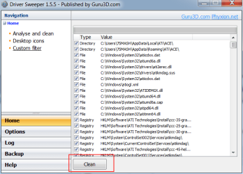

This sounds like it's time to 'start from scratch' so to speak.
► Download and install Driver Sweeper
Next, go to:
► Control Panel > Uninstall a program
► Uninstall ATI Catalyst Install Manager (to remove CCC and Uninstall the driver )
► Re-boot into Safe Mode.
► In safe Mode, run Driver Sweeper and select ATI - Display > Analyse
► Then Clean
► Once done, Reboot normally
Windows should now install an ATI driver
► *Optional* - Open Device manager > Display Adapter > r-click on the card and select Uninstall. You should now revert to the generic Windows VGA driver.
► From here, you can either install either 10.3 or 10.6 (whichever is your preference)
Hopefully both driver and CCC should be functioning properly. If not, there are a few other extra steps to try.
Reverting to an older version of Catalyst can be a PITA because of the framework versions as well as leftover registry entries that cause conflicts etc.
