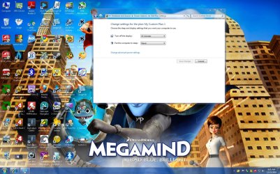

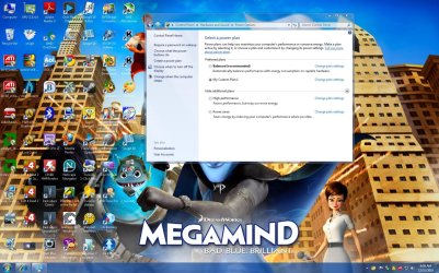

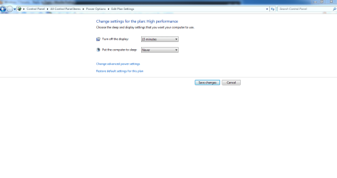

do you have any hibernation or sleep mode enabled also i did mention this issue in above post of the card loosing signal when turning off the flat panel tv
the only time it doesn't loose signal if you are changing chanels but for the most part that has happened to me if i dont set the tv to hdmi before swapping monitors it wont pick it up correctly if it isnt on that moment and when you shut it off i think you only broke the signal and would have to reset
I would just use a screen saver power mode and just let windows turn off the monitor that way you will still save power but can move the mouse to activate it
use the power plan feature make a custom plan that way windows can shut the monitor down for you and can walk away from downloads .....I hope this helps I don't think it is the card personaly unless it really has bad lines and black screens keeping display from being shown i think you're card is fine
YEEEEEEEESSSSSSSSS!! I DONT BELIEVE WAS SO SIMPLE!!!
After i full format the hard disk and reinstall everything i forgot the power plan and was <<turn of the display in 15 minutes>>
And i always off the mouse because is wireless to save battery.So thats why all this happent.
Solarstarshines you found the solution.
Thanks!!
