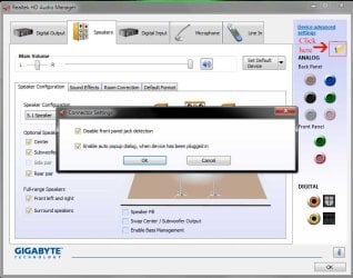

Not sure what you might have tried to solve it but just in case see the pic and if you open Realtek HD Audio Manager in Control Panel then click on the yellow folder icon as shown in the pic and untick Disable Front Panel Detection it might help

Thanks,unfortunately realtek user interface is not showing at all,i can see the drivers installed in add or remove program,before i set the system to factory settings,it does showed the realtek interface even that time the interface doesn't looked like yours,it just had the basic options .
