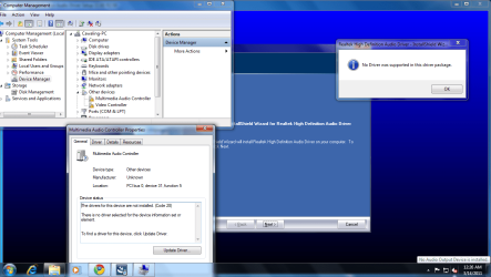

sadly not...nothing changed
Windows 7 Ultimate x32
i've attached a picture. .in this picture ive restarted the computer after installing the driver using the ZIP file, and now ive tried installing the driver using the EXE file...but as the picture shows the there was an error, "No Driver was supported..." but ive checked the device manager and looked at the properties of the "unknown device(Audio controller)"..
PLEASE HELP up until now i still dont have the right driver for this hardware.:(

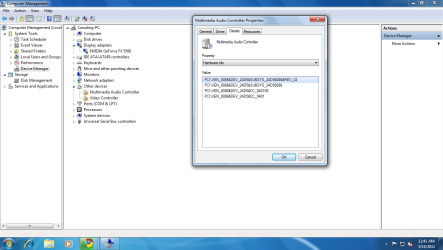

Can you pleases post what it shows for the hardware IDs for the multimedia controller, just to confirm what it has.
Also what does it show under "display adapters", as from that screen shot Aero is quite clearly working and yet Device Manager is showing an unknown video controller as well.

here are the requested pictures, as of now, im downloading the other EXE file from realteck which has around 83MB..
as for as display adapters, i have NVIDIA.

Following the instructions here http://www.sevenforums.com/tutorials/73420-hardware-identification.html and using the values of 8086 for the vendor and 24D5 for the device reveals that you have SoundMAX audio on your motherboard.
Well isn't that nice. Asus lists it as Realtek HD and has drivers for it, and yet the IDs show it to be Soundmax. Now with that said using the IDs it looks like it is the Soundmax 1888 audio, which from what I can find at the moment there is not now and probably never will be a Windows 7 (or Vista for that matter) driver for it.
I did manage to find this Asus board,
http://www.asus.gr/product.aspx?P_ID=neVcvuSgEUZcO3rK&content=download
that has the same Soundmax audio on it, as well as a driver for it. I downloaded and checked the INF in it and it does have the same IDs as what crowO7 is showing in those screen shots. Short of getting a sound card that has Windows 7 support you can try it with the last XP driver from the above Asus link. Make sure to uninstall all the Realtek drivers first before installing.

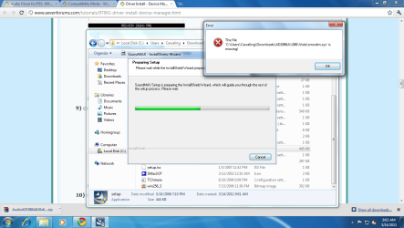

an error occurred during installing the soundmax driver...:(

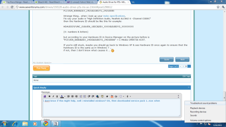

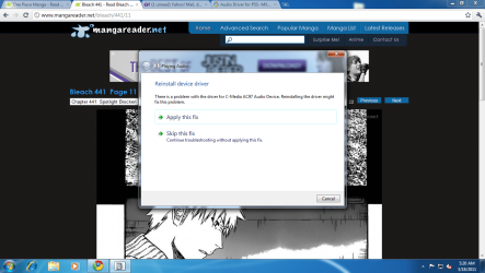

i dont know if this might help, well i reinstalled windows7 OS, then downloaded service pack 1..now when i troubleshoot my audio driver it says C-MEdia AC97'...should i go through with its installation or not?

Based on what toshikijima posted above and with what Windows is now identifying it as, I would go with one of the C-media drivers that he linked too.
