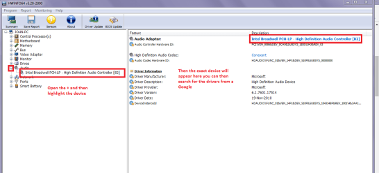

FOR OTHER COMPONENTS
PART B:
Open each small square with + in it on the section the components are in and then click on the individual component/s (it will highlight in blue) - in the right hand side will appear all sorts of details including brands speeds and other essential info that particular device. See pic for example.
Use PART B: see my pic for an example

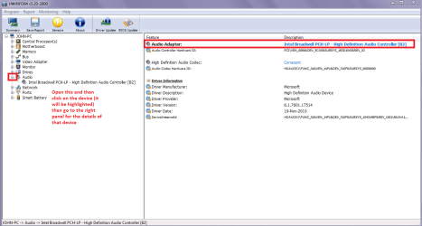

I cannot see that it has anything to do with audio problem though. Now just out of curiosity how did you find the driver for the headphones and more importantly the mobo audio device? I ask because the Dell site is such a convoluted place to try and find the drivers for anything really.
If you want to to find the exact device for the audio you can use the HW Info again and use PART B: to find the details of it see my pic of my laptop here.
