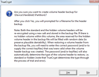

I think from my understanding of this warning message that backing up the main header also backs up the hidden volume as well. Is that correct?

I assume backing up the headers is something you only need to do once? Not a regular thing correct? I know if you change passwords you would need to re-backup the headers, but that particular issue isn't a concern.

Yes, you will only need to do it once.
It's been a while since I've read through the TrueCrypt docs, but the way I remember it is that the hidden header is attached to the end of the normal header. I think it operates the same way as the free space plausible deniability with the hidden volume inside of the outer volume, in such a way that there is no way to tell if the hidden volume header is bogus data or not (unless you have the password of course).
