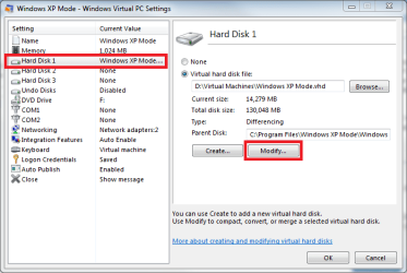

Do not forget to backup the vmcx file in C:\Users\Your_Username\Virtual Machines\.

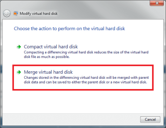

By default, XP Mode is divided to two virtual hard disks. The base, or parent vhd contains the 'not negotiable' part of XP, system core, files needed to run XP. All user modifications, installed apps etc. are then stored to the XP Mode vhd.
However, if you want to, you can make XP Mode to use only one vhd by merging the base, parent vhd and the XP Mode vhd. Here's how:

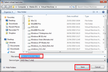

  • Go to XP Mode settings, choose Hard Disk 1 in left pane, click Modify
  • Click Merge virtual hard disk
  • Choose New file and browse to a location where you want to save the new, merged vhd
  • Give a name to the vhd, click Save
  • Click Merge
A new standalone XP Mode vhd is now created. It does no longer need the base vhd. Notice that merging takes quite a long time.

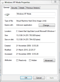

Theoretically, merged XP Mode vhd is a bit smaller than base & differencing vhd.
The maximum size of a Virtual PC vhd is 127 GB. When a new virtual machine is created, or XP Mode run first time, there are two types of vhd to choose:
  • A dynamically expanding vhd takes only as much space on your host hard disk as needed but is automatically expanded when you add data to it. The size of a dynamically expanded vhd is measured and shown in two different ways:

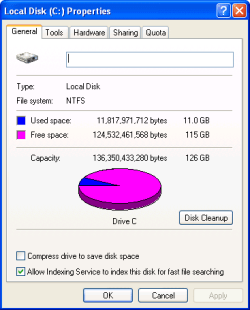

    1. XP Mode > My Computer > Hard disk C: > Properties shows always the maximum size -1GB, 126 GB. The actual space needed can be seen in mow much of this 126 GB is used, in my case space needed is 11.5 GB
    2. Host computer > C:\Users\Your_Username\AppData\Local\Microsoft\Windows Virtual PC\Virtual Machines > Xp Mode.vhd > Properties shows another figure, in my case 13.2 GB. This is because a dynamically expanding vhd must be "a little ahead of the time"; it has already reserved almost 2 GB to be ready to expand. This is the real, actual space the XP Mode vhd is taking on my host's HD at the moment
  • A fixed size vhd. The user can choose the size of the vhd. This size must of course be at least as much as is needed to install the OS in question, in case of the XP some 20 GB would be enough to most users as the size of the HD1. Because it's fixed, it's size is shown correctly both when looking from inside the XP Mode and from host
So, theoretically a differencing XP Mode is base 1.2 GB + 127 GB, when a merged XP Mode is "only" 127 GB.
Dynamically expanding vhd is default. If the user only clicks Next and OK, accepting default choices when installing XP Mode or creating a new virtual machine, it is created using dynamically expanding vhd. Personally, I find no reasons to use fixed size; a dynamically expanding vhd is more practical because its ability to grow or shrink, depending how much data I add or remove.

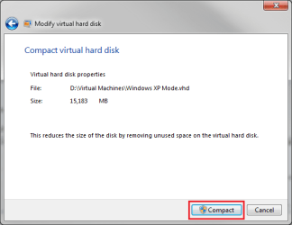

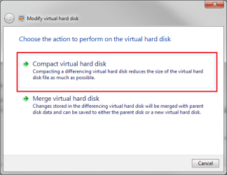

If you need to free some space in your host's HD, you can try to compact XP Mode (or any other) vhd. Compacting is more effective when using fixed size vhd, a dynamically expanded vhd is already about as small as it can be.
To compact an XP Mode vhd, choose XP Mode > Settings > Hard Disk 1 > Modify > Compact virtual hard disk > Compact:
