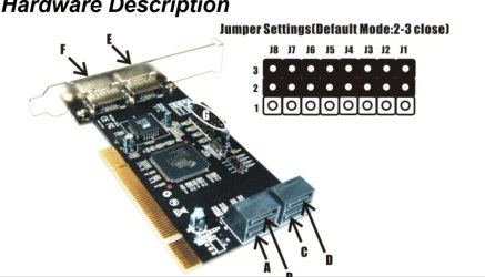

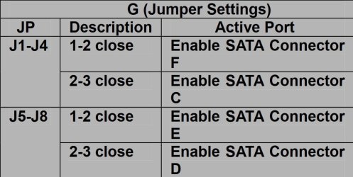

You're just using internal ports? There is a jumper and by default the external eSATA ports are disabled. You can only use four HDDs at a time. See screenshots.

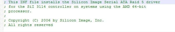

The driver appears to be for RAID only.
You shouldn't need the driver for legacy operation. I'm assuming by Vantec's use of the word "legacy" they mean non-RAID and just straight up using each drive individually like your intention.
On the first card, I am using the internal ports.
On the second card, two internal and two external eSATA, mostly to keep so many wires from inside the case.
