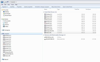

- I can't change the icons of all the HDDs (and partitions) in Explorer (please see screen shoot attached).

Many thanks for your feedback and taking the time to have a look at the 'msinfo'. Not sure if I could make a lot of sense of it?!
I did uninstall both the TuneUp Utils and qBittorrent, which I reinstalled. But because it seems like a good idea to have some maintenance software installed would you have a suggestion re. another maintenance program, free or not? Also, what about the 'funny' icons of all the HDDs and partitions in the Explorer? It's not really a biggie but I'd prefer them to look nice and not naughty :).

Hi John,
W7 does a pretty good job of looking after its self, and i would never let loose any Optimiser that touches the Registry.
have a read of this tutorial for some hints and tips
https://www.sevenforums.com/tutoria...sQFnoECAAQAg&usg=AOvVaw3YOT_oaMoaFHCPHTNJHdR4
OK lets have a look at the icon prob,
in a way this follows on to the tutorial i linked.....please run the following(OS and HDD checkers)
sfc /scannow
Chkdsk /r
Run them from an Admin command mode, and note the space
please attach the log, its in C>>>Windows>>logs.. CBS(the top one)
if the above doesn't help, see these
Desktop Icons - Change or Restore Default Icon
Drive Icon - Change

Hi Torchwood:
Again, many thanks for your feedback. As for the CBS file, I uploaded it to Dropbox because: The following errors occurred: CBS.log: Your file of 1.45 MB bytes exceeds the forum's limit of 1.00 MB for this filetype. I hope the link works.
With regards to the icon business ;), maybe trying one of these options might be the fastest way to fix this problem: Icon Cache - Rebuild: either Automatically Rebuild the Icon Cache or Automatically Rebuild the Icon Cache?!

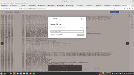

Hi Torchwood:
I'm sorry there seems to be a problem with opening the CBS log. When I click on it (Login - Dropbox) it opens after 1 or 2 seconds.
It seems, though, that only I have access. To share it, i.e. make it available to you, I apparently would need your email (see screenshot below). I don't know if you're comfortable sharing your email...
If there's another way to make the CBS log available to you, please let me know. Again, I'm sorry this seems to be a bit complicated.
Anyways, thanks so much for your help and commitment!
John
