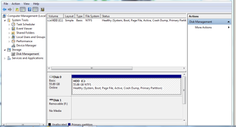

Disk Management Drive Map Snips
The first snip is all that would fit on the screen. 2nd snip is a continuation of the drive info.

It looks correct.
