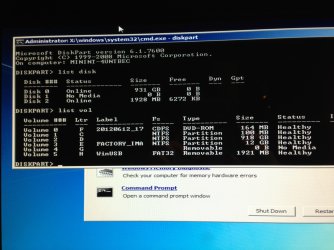

bootrec/fixboot
and bootrec/fixmbr
were succesfull?
recovery environment->command prompt
diskpart
list disk  (is there only 1 disk?)
list vol
exit
What volumes do you see and explaind what they're for

Yes they were both successful.
I just took a picture of the diskpart
Type:
sel dis 0
list part
sel part 1 (for System Rserved partition)
Det part
Doe it say it's Active?
If not type:
Active
exit
Now run Startup Repair - Run up to 3 Separate Times no matter what it reports.
If this fails to Start Win7 change the Active flag to C and try again.
These are listed in Troubleshooting Windows 7 Failure to Start
along with everything else that can be done to start unbootable Win7.
It said active and I was trying to do what you recommended but when I was supposed to type in Del partition, I didnt capitalize the d so it deleted it...I know stupid...

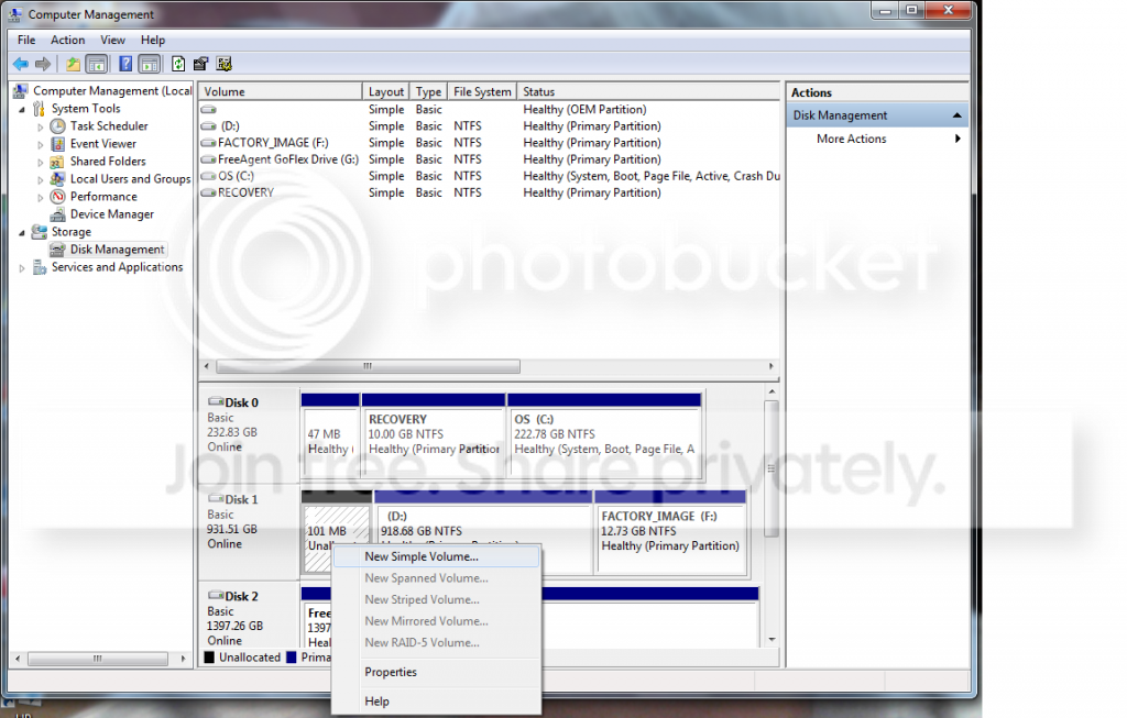

So I plugged the hard drive into my desktop, and in disk management, saw the 100mb partition I deleted and went through the steps so I could use it. I then put the HD back into the touchsmart and made the partition active and ran startup repair three times. But I still get bootmrg is missing. Also I went into the bios settings and saw that the DVD was first in boot priority so I restored the defaults but it still is. Why is that?

We have no idea what you did when you plugged in the HD to recover the 100mb partition. Can you post back a screenshot of the maximized DIsk Mgmt window showing drive map with all listings?

I plugged it in to my desktop and opened disk managment. I saw the partition said unalocatted.
I right clicked and clicked on create new simple volume.
Then it looked as it does below.
Then I plugged it back in to the touchsmart and booted the repair disk and then in diskpart, made the partition active, rebooted, ran startup repair, rebooted, ran startup repair, rebooted, ran startup repair, and tried to boot into windows and I am still gettting the bootmgr is missing message.
