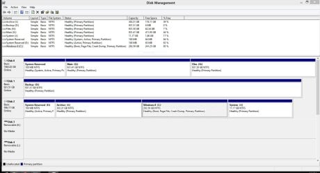

ok.

I notice the OS you're using for screenshot Windows 7 on C is being booted by it's own System Reserved partition on the same DISK2. This is signified by C showing the Boot flag meaning it is the presently booted OS, while it's System Reserved is marked System which means it is booting that OS.
What we can't see yet is which System Reserved partition is booting Windows 8. So reboot into Windows 8 and provide another screenshot please.
If Windows 8 is also being booted by the System Reserved partition on DISK2 it will be marked System in Windows 8 too. This means Windows 8 is no longer being booted by its own System Reserved partition and it should not be marked Active as that will interfere with the boot.
The cleanest arrangement for separate hard drives is for each disk to boot itself, then set the preferred OS hard drive first to boot in BIOS, trigger the other one using the one-time BIOS Boot menu key. If this is not to your liking, install EasyBCD to the primary to add the other OS to a Windows Dual Boot menu. We can give you the steps to do this as we've done thousands of times before.

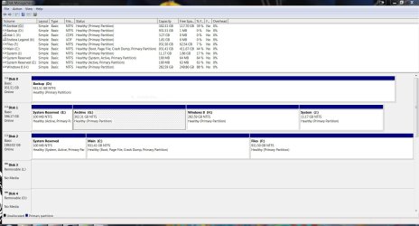

Here is disk management from windows 8. Also I already have a dual boot menu set up, with windows 7 set as the default OS. I'd prefer to leave it that way if possible. I used easybcd to set up the dual boot.

Both OS's are being booted by the Windows 7 System Reserved partition on DISK0, which we know because it remains flagged as System partition no matter which is booted.
This means the Windows 8 System Rserved partition on Disk 2 is no longer being used, yet it has an Active flag which means it could well be interfering with boot.
So try marking the System Reserved partition on Disk 2 Inactive to see if that helps: Partition - Mark as Inactive - Windows 7 Forums
If you ever remove Windows 7 you may need to mark Windows 8 partition Active again and even possibly need to run Windows 8 Automatic Repair
