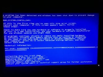

I then ran the Ccleaner which he had on his computer which cleaned up files, then ran the Ccleaner registry and when I rebooted, I got the BSOD.

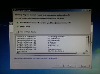

I tried to do a Startup Repair, but it says it could not repair the system, but in the report, it says my registry is corrupted.

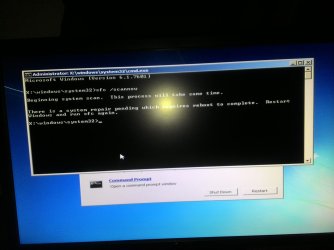

Tried to run a sfc /scannow, but it says there's a system repair pending and to reboot and run the sfc again.
Tried to run in safe mode, but keep getting the BSOD.

Yes, when it comes to this sort of thing where malware and Adware crap is abound, I'm afraid a format and reinstall of Windows is more suitable.
Backup the data, scan that data in a live system and reinstall Windows.
That BSOD is more than likely due to something (malware/Adware?) messing around with drivers. 99% of all BSODs are driver or hardware related. Install a bad driver and get a BSOD. Something messes with a driver and get a BSOD. Install bad hardware and get a BSOD. You get the point. The Whocrashed program can help...
- - - Updated - - -
Oh, Ccleaner registry cleaner is snake oil and will F%^7 your computer up. you DO NOT need to EVER "clean up" a registry. No one should EVER mess with the registry, Now you see what happened. Ccleaner is also a real "crap" program. Just use SystemNinja once every few months and call it a day.
You might be able to run the Windows 7 recovery environment and invoke a system restore point therefore writing the registry back. Hopefully...
