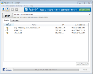

Thanks for the cool tool. Here's what it found:
I think the HP device is our wireless printer which is plugged into the router now. Just turned it's wireless radio off but the listings remain the same after Scan.
Doesn't look like the conflict continues. But I also don't see the Ipad around today. May need to run it again when it shows up again.

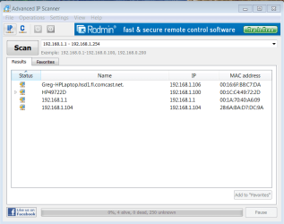

The Ipad returns. There is also an IPhone so the new fourth listing might be either.
I think the 3rd listing is the router?
IP leases expires and gets renewed also. If the next IP conflict happens again, try running the AdvancedIPScanner. I use this for home and work, it comes handy. Although my Dlink router also displays a similar information which is kind of cool too.
