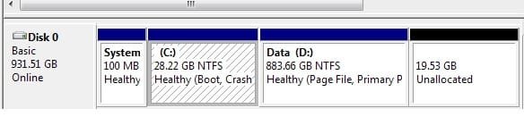

I've attached it. Most of all I just don't want to reinstall W7, drop the data partition back onto the disk and then be told that my shortcuts and program installs are no longer functional.

You would have to reinstall your programs if you reinstall Win7.
It would be much easier to use free Partition Wizard bootable CD. Free Download Magic Partition Manager Software - Partition Wizard Online DoubleClick on downloaded ISO file to burn to CD.
Boot PW CD, select 1 for Screen Res, rightclick D>Resize, slide left grey border to the right by as much space as you want to extend C into. Click OK.
Next rightlick C>Resize, slide right grey border to the right to take up the space you made from D, OK. Apply all steps.
Done.

A success! Bootup took a strangely long amount of time at the tail end of the Windows logo (perhaps a consequence of the fragmentation of the drive thanks to moving everything around), but other than that it worked a treat. Thanks!
