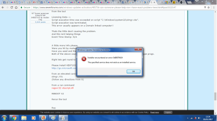

Just got this error when trying to install :/
Windows 7 Home Premium 64 bitB950
Acer Aspire 5750Z
B950
OK,
thats because its trying to use the broken windows update.
run the other fix's then try it after rebooting.
