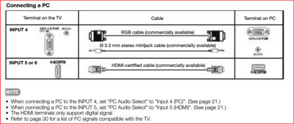

Sharp LCD model no: lc32sb27u
XP
XP
From the manual for your TV,
Unless your laptop has a HDMI port on it you need to use the VGA cable you have, and instead of the audio cable you posted you need one with the 3.5 MM jacks on both ends, not one with split RCA ends.

If I purchase the 3.5mm (1/8") Male to Male Stereo Audio Patch Cable (see attachment) and use it along with VGA cable, then I guess I will be able to get video and audio.
Am I correct and is the cable in the attachment correct one?
XP
XP
Yep that's the one.
And yes you will, just have to set the audio and video to PC in the TV's settings.
