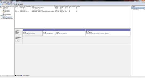

suggest you post a copy of your Disk management setup

As requested. Here is my Disk Management screenshot. It looks normal though, so why is it that I can't access the Setup screen using either my Windows 7 OS CD or a bootable USB?
Please help.
Also, I have made a backup system image. If I can't access the Setup section, does this mean I wouldn't be able to restore my backup image?

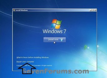

I still don`t understand why you keep saying you can`t get to this window after you boot from your install disc or usb stick.
@AddRAM , let me try to explain exactly what happens:
1) Shut down PC
2) Boot PC, pressing F12 to get to Boot Options
3) Insert Disc
4) Select to boot from CD
5) Press a key to get to next screen
6) "windows is Loading Files..."
7) Get to Installation Screen
8) Cursor is stuck on German language selection
9) Cursor does not respond
10) Keyboard doesn't respond
I'm at a loss.
