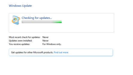

Everything went fine on the install, but at completion I was left with Internet Explorer 8. The first thing I did was to run Windows Update. About 5 hours later I checked it and it was still looking for updates, so I killed the task. I then opened Internet Explorer, got the msg that I was using an old browser along with prompts to download IE11, which I did, successfully. I then retried running the updates and got the same perpetual checking for updates.

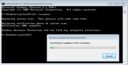

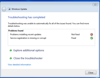

I then ran an sfc /scannow, got no integrity violations, and then downloaded and ran the SURT package for my system. I let it run all night, and still got what you see here. I then downloaded and ran the Windows Update Diagnostics hotfix, which gave me nothing.

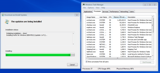

- I performed a clean boot and tried to run the SURT again. This time it actually DID something beyond the box 'searching for updates on this computer'. I got the box shown here, indicating that updates are being installed. Eureka! Or so I thought. It never completed. Even after letting it sit for about 12 hours, it refused to finish that last 8% to 10%
- Ever since Windows finished installing with the new drive I've been plagued with high CPU on an svchost task. I've tried killing the task without effect. I've tried letting it alone without effect, thinking that it must be related to the update it's 'trying' to do, and that as soon as the update finishes, the svchost memory drain will disappear. But of course no updates ever complete, so I'm left with the quandary
