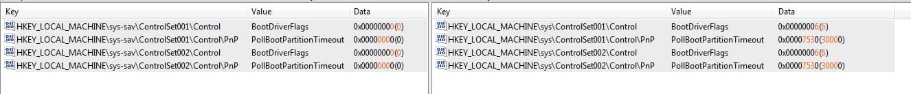

that changes the values on the left to the values on the right in this pic

PollBootPartitionTimeout registry key value is used to control how long the kernel waits for PnP to surface the boot disk before it stops with bugcheck
To allow the system to load from a USB device, the USB drivers are loaded during boot, rather than on demand.
that is why those two values are set.
