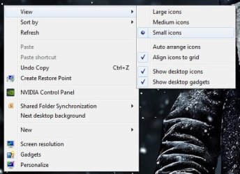

But icons are too big, at 100% and things are slightly out of focus.
Have you tried right clicking on the desktop and choosing small icons?

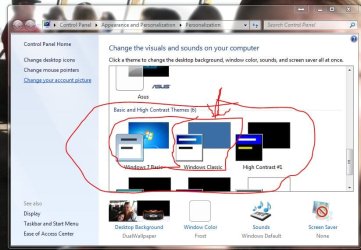

It looks the same with the windows backgrounds.

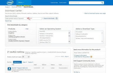

Here is a link to the Intel download page for that chipset. It shows support for up to windows 7 64bit.
I would download the correct driver for your version of windows. 64 or 32 bit then
Uninstall the current graphics card via the management console and be sure to check the box that says remove driver. install the new driver before rebooting to keep windows from automatically installing their own driver.

When I go to that page I see a red line that says "No downloads available."
I already went there and tried their scanner and got nothing.

Ok you can try reentering the chipset model where indicated. I found windows seven 64bit on that page. It might be because you used their diagnostic tool. you can try clearing cookies before proceeding to that page. If these drivers don't work I would suggest contacting the builder and taking in the monitor as well to show them what is happening. It sounds like they did a Frankenstein build and hopefully have a warranty.

OK. I got the download and installed it.
But my screen looks the same.
