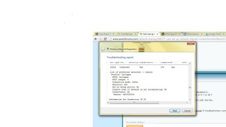

hoo...doesn't help...
u use Mcafe ?
If i use IPv6,I can get network,so I disabled it,,
before you get problem,you use ipv4 or 6 ? or all ?
or you can go to default gateway 192.168. bla bla..
setting in there..
or reset your tp link router...
or try troubleshooter them,see the detail if troubleshooter complete...
windows 7 ultimate x32My Mamma and My Pappa
