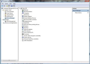

Okay, it's not a hardware problem, have you looked at device manager and the drivers?
Start > Computer > Right-Click Computer > Manage (need Admin rights) > Left pane (Under System Tools) > Device Manager
Here is some information for Device Manager to help you:

OK. Got there and there is an error sign (yellow square) on these devices listen under "other devices":
-Base System Device
-Ethernet Controller
-Network Controller
-Video Controller
Seems like drivers to me. How can I get them without internet? In other words, How can I download them and transfer them to the PC with a USB device?
Thank you very much.
EDIT: When I try to "Update Driver Software" it says "Windows was unable to install your *Name of the device*".. =/

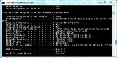

Open command prompt: Start > Type within "Search Programs and Files" > cmd > type IPCONFIG /ALL (see my screenshot) should find the name of the network card (:

Weird thing happened.. the command's output was:
Windows IP Configuration
Host Name . . . . . . . . . . :Holder-PC
Primary Dns Suffix . . . . . . . . . . :
Node Type . . . . . . . . . . :Hybrid
IP Routing Enabled . . . . . . . . . . :No
WINS Proxy Enabled . . . . . . . . . . :No
Nothing else.. =/ Although I've checked through other place and yes, it was WAN Miniport.
