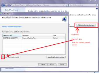

Have you checked for restore points in the Control Panel as per my pic? - tick the small box and see what comes up.
Now with the sfc did you run it as admin?? http://www.sevenforums.com/tutorials/1538-sfc-scannow-command-system-file-checker.html and if you can best done for about three tries.
