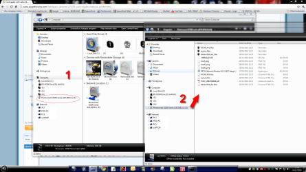

When you run windows explorer do you have a network connection like mine in the pic (1) If you do then when you plug a memory card into one of the slots in the printer you should be able to access it by double clicking on the icon (2) (but it won't be accessible unless there's a card plugged in)

Your picture is hard to see, I cannot read the line you circle.
On my windows explorer, it does show "Network", but that folder only contains all the hard drives and 2 printers connected to the system. On the printer that has the card reader, it shows nothing.
