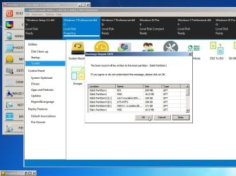

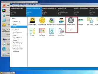

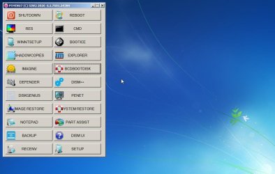

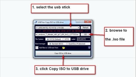

you can borrow my simple boot media
:ar: RECDISC7B.iso
it includes lots of useful tools and supports usb3 and nvme
could burn the above to a cd or extract it to usb stick using this :ar: View attachment Usb7ice.zip
- - - Updated - - -
Here is one example of the included tools
