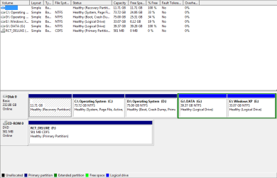

Ok, Here's what it says for my Partitions,
Drive C: Healthy (System, Page File, Active, Primary Partition)
Drive D: Healthy (Boot, Crash Dump, Primary Partition

Why are you wanting to dual boot a cloned OS with its clone? Please explain fully.
Then post back a full Disk Mgmt drive map and listings screenshot. Use Snipping tool in Start Menu, attach file with paper clip in Reply Box.

What is that XP logical partition shown in screenshot?
Have you reinstalled Vista from Recov disk to D?

Add: The Logical Drive that Say Windows XP has XP on it, it doesn't work anymore since I had the Hard Drive crash. I've tried to reinstall the boot loader for it, and when I try to boot for it, the computer automatically restarts.
