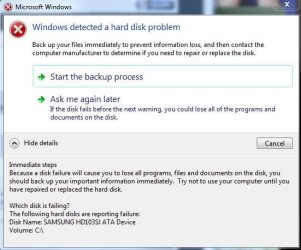

Little update: While in the shower this showed up. This is the 2nd time I have received this message and it must clearly mean my HDD is the culprit... Right?
That certainly makes it highly suspect. Back up your data ASAP. Then try chkdsk.

Checking file system on C: The type of the file system is NTFS. A disk check has been scheduled. Windows will now check the disk. CHKDSK is verifying files (stage 1 of 5)... 97536 file records processed. File verification completed. 66 large file records processed. 0 bad file records processed. 0 EA records processed. 44 reparse records processed. CHKDSK is verifying indexes (stage 2 of 5)... 138382 index entries processed. Index verification completed. 0 unindexed files scanned. 0 unindexed files recovered. CHKDSK is verifying security descriptors (stage 3 of 5)... 97536 file SDs/SIDs processed. Cleaning up 224 unused index entries from index $SII of file 0x9. Cleaning up 224 unused index entries from index $SDH of file 0x9. Cleaning up 224 unused security descriptors. Security descriptor verification completed. 20424 data files processed. CHKDSK is verifying Usn Journal... 37588640 USN bytes processed. Usn Journal verification completed. CHKDSK is verifying file data (stage 4 of 5)... 97520 files processed. File data verification completed. CHKDSK is verifying free space (stage 5 of 5)... 232113592 free clusters processed. Free space verification is complete. CHKDSK discovered free space marked as allocated in the master file table (MFT) bitmap. CHKDSK discovered free space marked as allocated in the volume bitmap. Windows has made corrections to the file system. 976657407 KB total disk space. 47923492 KB in 76725 files. 49040 KB in 20425 indexes. 0 KB in bad sectors. 230503 KB in use by the system. 65536 KB occupied by the log file. 928454372 KB available on disk. 4096 bytes in each allocation unit. 244164351 total allocation units on disk. 232113593 allocation units available on disk. Internal Info: 00 7d 01 00 8a 7b 01 00 92 ca 02 00 00 00 00 00 .}...{.......... 74 01 00 00 2c 00 00 00 00 00 00 00 00 00 00 00 t...,........... 00 00 00 00 00 00 00 00 00 00 00 00 00 00 00 00 ................ Windows has finished checking your disk. Please wait while your computer restarts.
There are the details from the chkdsk.
I've tried running the Samsung HDD diagnostic utility a few days ago (my HDD is Samsung) but it was failing to start for some reason. It was booting up but then saying I didn't have enough memory to do it. I'll try again tonight and post the results of it.
By the way the hard drive failure that was popping up has started popping up roughly every 20 minutes now. So much that I actually disabled it from notifying me so I could still use my computer for the time being.
Thanks for reporting back with the results. It looks like your HD is OK and and free space allocation problems have been repaired.
Try again to run the Samsung diagnostic program. Then run memtest for at least seven passes. Post back and we will go from there.
