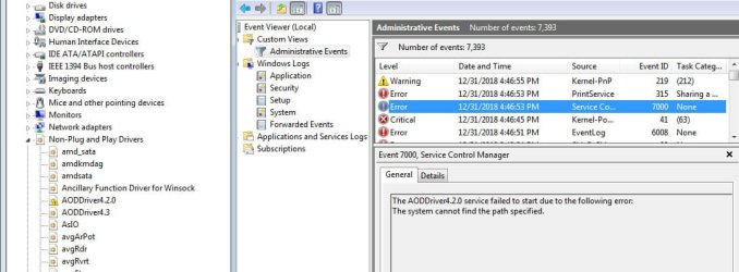

Thank you for the suggestions! I tried all* of these, and it seemed okay, but then froze again after a few hours of doing things. Thankfully this time was one instance it let me return from, which was good since I was in the middle of a drawing.
The only thing in event viewer that happened before the freeze is a dbupdate event, saying it can not be found. I don't really use Dropbox's application, so I went and disabled the services for it in case that is an issue.
*Disclaimer the only fix I haven't tried yet is the AODDriver4.2 fix which involved registry.... I attached an image below but I'm unsure if this is the correct fix. Isn't it already using the highest Driver?

Tried both the AODDriver 4.20 fix and the IE fix, just had another freeze it wouldn't let me come back from earlier. (2 regular shut-downs and start ups later)
Again still no event logs at the time of the freeze. One warning about 50 minutes before freeze occurred.
It could be that the hardware is just finally starting to die on me, I believe this machine was built around 2011-2012, so it's kinda old, and I know several components aren't being officially supported anymore. I guess I'll either try a comp repair shop to see if they can figure which part might be dying (I think in another thread dsperber suspected motherboard) or I'll just save and back-up often.
