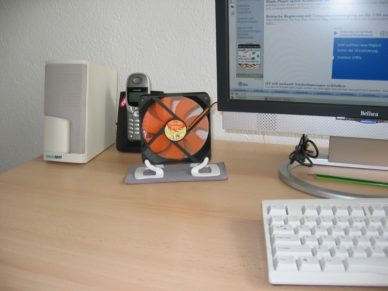

hmm! get a cooler for ur processor.
or change the casing
or add a side cooler
this cooler can be added into ur casing from inside.
