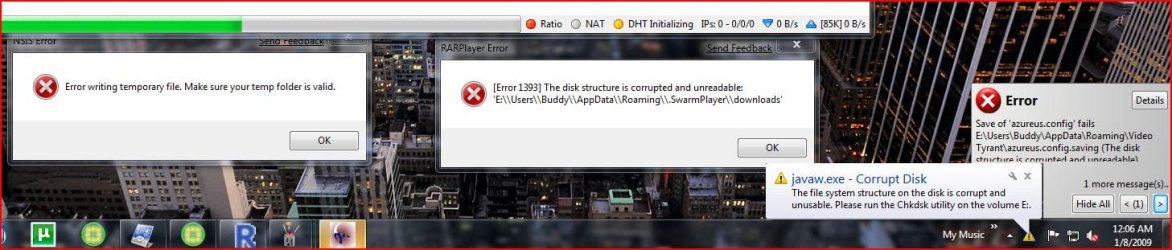

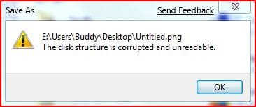

Please post a screen shot of the exact error message. We'll then direct you to the event viewer to search for possible causes.

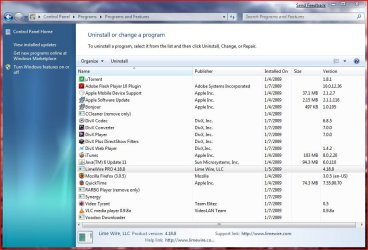

i tried to get as many errors at once to show the problem and i also included what programs i currently have installed. also i was thinking that if it were certain programs i was using then wouldn't more people be having this problem? i have only seen one other person on this forum with the problem.

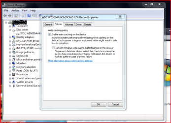

Can you post your hard disk Policies settings in Win7?

yeah its the same as the one you posted on both my drives
