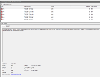

I am keeping an eye on it. I did a couple reboots and took a look at the event viewer. I seem to get a WMI error each time I reboot. Image attached.
Remove any unnecessary start up programs

First, thanks for your help thus far yowanvista. I AM learning.
This is a basic HTPC with little extra startups added, but I will try eliminating them to solve the WMI issue. But I just checked the event viewer as I woke the HTPC up this morning. Strange. I had two event ID 5's while the HTPC should have been asleep.
Event ID 5 Kernel-General
{Registry Hive Recovered} Registry hive (file): '\??\Volume{124fb507-d634-11df-a573-806e6f6e6963}\System Volume Information\SPP\SppCbsHiveStore\{cd42efe1-f6f1-427c-b004-033192c625a4}{ADC753FE-2D28-4EA5-8524-7D08EAF8FC8A}' was corrupted and it has been recovered. Some data might have been lost.
This computer has rarely been used on since it was given as a gift at xmas, but I have 21 of these event ID 5s.
In searching posts relating to this event during the sleep function I only found one, but they did not know how they fixed it.

OK. Using MSCONFIG I shutdown all startup programs. Rebooted and the WMI error was gone. Then one-by one I added them back. I now know which program is causing the error; the program for the little VFD display on the front of the HTPC case.
The only thing left is the event ID 5.
Then you should update that software
This is the latest software, but not showing WIndows 7 compatible. I have an email in to the mfr to recommend which driver to use.
With regard to all the other crashes. All the crashes and errors ceased when MSE was removed.:cool: I mean with the exception of the event ID 5 mentioned above the event viewer shows nothing critical or errors.
That is strange. I had been using AVG(in other computers), but switched to MSE because I thought MS would know their OS better than anyone. I did not expect that to happen. What antivirus program(s) would you recommend to avoid this in the future?

I have installed Norton and continue to watch event viewer. Nothing yet. It may be great, but has all the bells and whistles. I know I can turn them off, but all I ever wanted was a simple, effective, lightweight anti-virus program. Norton is not that.
So, do you think something went wrong during my installation with MSE to cause all the problems I was having?
Also- I am coming up dry on event ID 5. has happened may 10 times in the last month. Should I be worried bout it? Have any pointers there?
