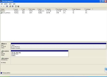

I have a 80GB HDD partitoned as C: & D:. I recently installed Windows 7. Although it installed perfectly, d: was not visible during setup. It is missing in the Windows Explorer. I tried diskmgmt.msc and the drive does not appear there.

Hi Brink,
I tried diskpart in windows 7.But it shows only the c: drive as disk 0. if I select drive 0 and list partition it shows nothing.A small problem. My brother in a hurry installed windows XP in the C: drive. But the D: is still missing. I am posting this screenshot from Windows XP. diskpart in windows XP is not working

Ah, ok. It would then appear that your favorite brother just wiped out D as well when he installed XP. :(
Ya but even if he wiped it, it should still show in disk management. This is odd.
Could it possibly have something to do with the fact that C: was formatted using FAT32 ??
And now disk mgt will only show partitions formatted this way ?
I`ve only used NTFS with XP so I`ve never come across this.

I suppose that would depend on if the HDD was deleted until "unallocated space" that would also eliminate the D partition as well, then the HDD formatted by XP when installed.

I would have to say that when I installed win 7, the unallocated space was 12 MB not GB. Also I used a full NTFS format option. When my bro formatted it to FAT 32, the unallocated space remained the same. I tried mini partition tool wizard pro, the D: drive is still missing.
