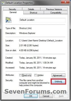

4. Right click on the Default Location shortcut, and click on Properties, General tab, and on the Unblock button. (See screenshot below)
NOTE: If you do not have a Unblock button under the General tab, then the shortcut is already unblocked and you can continue on to step 5.

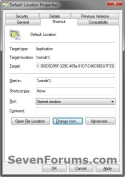

4. Right click on the new Default Location shortcut on the Desktop and click on Properties.

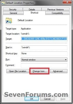

5. Click on the Shortcut tab, then click on the Change Icon button. (see screenshot below)
