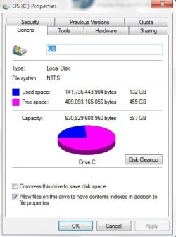

To be honest, I'll just play The Sims 4. Maybe record a few videos of The Sims 4. I may start back playing The Sims 3. Stream YouTube videos, Netflix, and have iTunes music. I have 2 Dells; 1 with all The Sims 4 but there's about 100gb of hard drive available. The other Dell that I start using and put The Sims 4 and it's lagging. That has over 459gb of hard drive available. The gaming PC, I would use it everyday to search the web, play The Sims, listen to music & watch movies/videos.

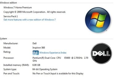

Kesha,
I did some looking around, and I did find out that your PC can take a quad core CPU, specifically the Intel Core 2 Quad Q9650. They are available on eBay for not a lot of money. I don't know what you have in your PC at the moment for a processor, but a quad would definitely help the performance. Especially if you currently have a Celeron or Pentium CPU right now. The Core 2 Quad Q9650 is a major speed increase over the Celeron and Pentium chips.

Mellon Head - Awesome, thank you so much! Yeah, I can do that. I attached of photo of the processor I have.. I think I have... If I didn't, I'm sorry. But if you tell where to find it, I can let ya know! Thank you for looking!!

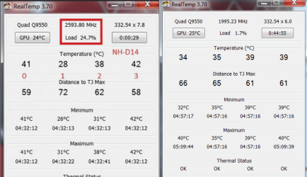

Just to show a bad and good cpu or what I said was bad is here
The left core temps were so different it was weird to me
The good one on the right shows only a 4c temp difference which is the one I finally kept :)
All 3 9550's worked but only the last was in my mind normal or should be normal :p
