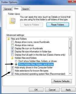

Go to the control panel and find Folder Options. In folder options select to show hidden folders.
Now browse to this directory that will contain your Firefox profile.
C:\Users\--insert your current username--\AppData\Roaming\Mozilla\Firefox\Profiles
Backup your profile folder to the desktop.

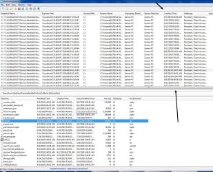

Run ShadowCopyView. https://www.nirsoft.net/utils/shadow_copy_view.html
Find an older shadow copy and click on it in the top box. They are listed by date. See my image.
Now in ShadowCopyView search for your profile in the bottom box after clicking on an older shadow copy. You have to double click C drive and go all the way through to the users folder, etc, etc. The same path as was in Everything.exe. You are looking for the two files key4.db and cert9.db. When you find each one, right click and copy them to a folder on your desktop. DON'T copy directly to the desktop otherwise you'll over write your backups.
Now once you have found older copies of key4.db and cert9.db, paste those in your current Firefox profile replacing what is there.
If all done right, hopefully your master password will work. If not, you may have to use an even older shadow copy.

You may need to turn on show hidden folder and show extensions. To do that go to the control panel | folder options and see my image.
