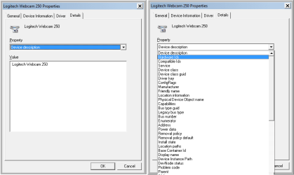

  2. Now that you've found your device, right click on it and select properties.
  3. Click on the Details Tab.
  4. Drop the 'Property' box until you find 'Hardware Id's".
    This picture shows my webcam, but unknown devices have hardware ID's too
  5. You'll find some number-letter combinations, here's what they mean:

  6. In my screen print I've looked up my Webcam again. My PID=0804, My VID = 046D.

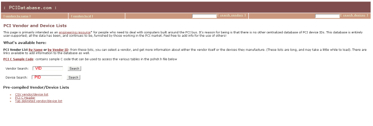

  7. We need to reference these, so open your browser of choice and navigate to the www.pcidatabase.com website.
  8. There are other websites, but I think that the PCIdatabase.com team has put together a great site with a lot of information should you need to know more about devices and drivers.

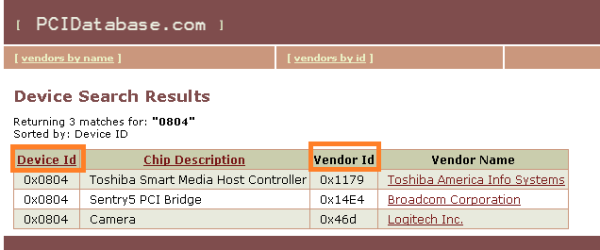

  9. Type your PID where it says Device Search and press SEARCH (e.g. for my example I type in 0804 and click on the Search button to the right of the Device Search box).
  10. All Devices with that PID show. This is usually enough; but sometimes multiple devices will show.
  11. If you have multiple Devices, then you need your VID, so look back to your details column under Hardware ID's and reference it against the Vendor ID column with your VID. Mine was 046D and you can see 0x46d in the Vendor column. That's a match.
  12. You've now identified your device and can now search for the correct drivers for it.
