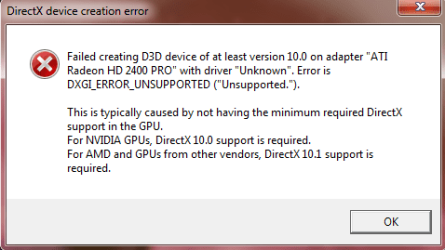

That looking like the video card is at fault. Is that really an ATI HD2400???
You need to find drivers for it. You might also check out the system specs for the game as that error is saying you need a Direct X 10 card and I'm not sure the 2400 is. Could be wrong though as I haven't looked it up yet.
Edit: the 2400 is DX10 capable - ATI Radeon
You can try and find drivers here: ATI Video Card Drivers
For HD 4000, HD 3000 and HD 2000 Series: AMD Catalyst
Update your DX files here: Update your Direct X files

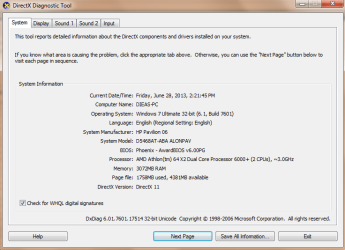

I know everything else works but now the problem is when I try to update DirectX to 10.0 it comes out as unsupported type of file and i'll give you the image. I'll also give a screenshot of the program you suggested me to.
Site for BF3 Specs... http://bf3blog.com/battlefield-3-system-requirements/
This is the picture of the unsupported DirectX (I dont know which program to use to open it I tried java didnt work)spec2.png
Here is the picture for the specs of my computer using the program you have me -spex.png

First I don't know what I'm looking at in that first screenshot, but that isn't needed for you to update DX. You need to use the link I provided and follow those instructions.
Secondly, it appears your ATI HD2400 Pro is not support by the game....
Minimum requirements for Battlefield 3
  • OS: Windows Vista or Windows 7
  • Processor: Core 2 Duo 2.4 GHz or Althon X2 2.7 GHz
  • RAM: 2GB
  • Graphic card: DirectX 10 or 11 compatible Nvidia or AMD ATI card, ATI Radeon 3870 or higher, Nvidia GeForce 8800 GT or higher.
  • Graphics card memory: 512 MB
  • Sound card: DirectX compatibl sound card
  • Hard drive: 15 GB for disc version or 10 GB for digital version
The game requires a 3870 or higher, you have a 2400. Basically the card isn't strong enough for the game. You can do the updates like a stated in my first post, but I suspect they aren't going to help. You'll need to upgrade (get a newer) video card.
