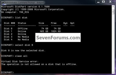

I just did this on my SSD and at first I thought to make the SSD "Offline" in disk management but in the command window it said that it could not "clean all" on a disk that's "Offline"; you may want to add a mention of this in the tutorial; I'm sorry I didn't think to get you a snip of it, but it should be easy to replicate. :o
It only took about 15 minutes to do a "clean all" on an 80GB SSD, not bad.

Here's the snip, I re-did it for you.

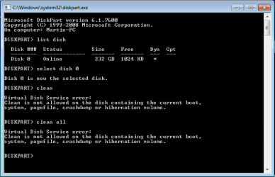

I'm sorry but I followed every step carefully and it just won't work... Here's a picture of the commands... Thanks for any help. I want to convert back to a basic disk, that's all. But nothing is working...
