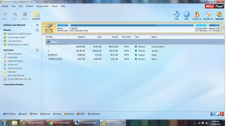

I have Partition Wizard 9.1 and the attached picture below is the screenshot of the main GUI. It shows bad disk on the particular hard disk

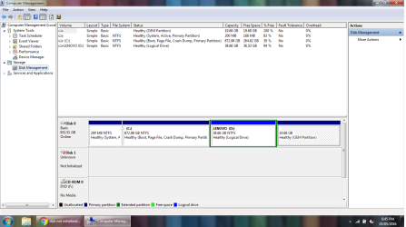

Here is the screenshot in disk management when HDD is attached to Windows7 via USB SATA.
The HDD does not show in PW though.

OK, your WD 2TB drive was in fact a secondary drive in your Windows 10 system which you have now replaced with another WD 2TB drive.( We normally call the boot drive as the Primary HDD. Any other internally connected HDD is a secondary drive and a data drive.)
Now coming to your present setup, Windows 7 laptop, the WD 2TB drive plugged in with SATA to USB adapter. PW does not recognise it.
Download, install and run Data Lifeguard Diagnostics for Windows. Run as administrator. Software and Firmware Downloads | WD Support
Perform a Quick Test - Only the Quick Test - and post the results. How to test a drive for problems using Data Lifeguard Diagnostics for Windows | WD Support
If the diagnostic software does not recognise the presence of the WD drive - No DIY data recovery is possible. Most probably the electronics PCB in the HDD has failed. WD Data Recovery Partners may have the exact replacement board and be able to recover the data. You may not get the exact replacement PCB.

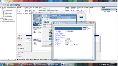

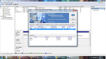

Ive ran the quick test. Test results shows pass but with 0.0GB capacity ive attached the screenshot in this post

It is a false positive. It reads 0 GB - does not read even one single sector - and gives a PASS. If the drive is recognised correctly it should indicate the Model Number, Unit Serial Number, Firmware Number, and Capacity as in the screenshot below.
It is definitely the failure of the PCB in the drive. Look at the PCB very carefully. There should be some sort of part identification number in it. ( It could be in the invisible backside also).You should get exactly the same part number board if you want to replace it. As I said it may well be impossible to get the same part Number board especially if it is a many years old drive. Manufacturers change the chips and/or firmware in the board often. So the board in the same model current drive may or may not work. Lots of uncertainities. The data recovery job is best left to WD Data Recovery Partners, who as I said may have the board in their jig, or even rejig one with the same components, flash the same firmware and recover the data. I do not know exactly what they do but they can do it. If you want to get your data , cost no matter that is the only way to go. You can contact the data recovery partners in your zone and discuss. Telephonic consultation is free. They may also give you a quote.
