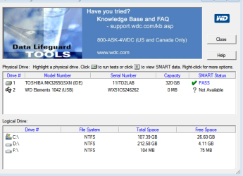

I downloaded the utility & ran it.Attached is the scan result.
I idnt ran Write Zeros as it will erase all the data that I have.Please suggest.

False positive. The extended test did not run really. It should have taken quite sometime to check each and every sector. In your case it would have finished in a quick second for it really did not run.
Without doubt, your external HDD is faulty. If it is under warranty, contact WD and get it replaced.
If it is not under warranty, you may remove the HDD from its casing, plug it in as a second drive on a desktop and check whether it reads. (In some WD external drives the interface SATA to USB electronics is integrated into the drive and in such a case you may not be able to connect it as a second drive.)
If it does not read it is the HDD that has died and no DIY data recovery possible. Needs professional data recovery service.
