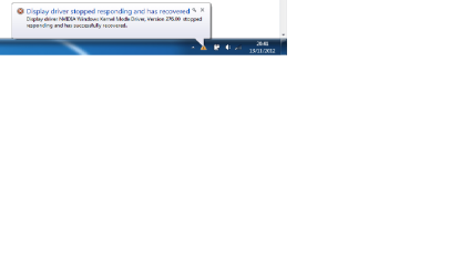

I've only had my laptop for less than 2 months but now everytime i try to watch something on youtube or iplayer this comes up sometimes the screen freezes for ages or it will go black and come back other times when I try to open task manager it would go black and nothing happens so I have to force shut down
I haven't changed anything on my laptop either...
Can anyone help? I'm not good with computer I don't know the first thing about them
What do I do? Can anyone help me pleasseeee
Thank you to anyone in advance who post's back :)
Now it happens when I am simply using Microsoft word typing my assignments :S
can anyone help please
Hello Shakilla. Welcome to the forum.
You are dealing with a TDR error. Please read through the troubleshooting list below and perform as many tests as you can.
Many of the tests are for desktops. You can ignore those.
For you I would concentrate on overheating problems, and drivers.
A common problem with students is they use their laptops on their beds, and the bed linens block the vents on the bottom of the machine causing it to overheat.
More information about your laptop would be helpful.
Since your laptop is still under warranty you want to be careful about making any changes inside the machine.
"Display driver xxxxx stopped responding and was recovered"
Timeout Detection & Recovery (TDR) = "Display Driver Stopped Responding and was Recovered" is a useful feature that started in Vista and is also in W7 that allows the OS to try and recover from a video timeout so that the system does not crash to a bluescreen. Symptoms included a screen flash with the TDR message appearing one or more times or the screen blinking out to black. If the system cannot recover it will crash (Stop Error 116 typical). The issue is that the video card is not responding as expected. The solution is in the: why?
There is no one-size-fits-all solution to TDR errors. But the problem is usually found in the local environment (your computer). Finding the cause is a matter of checking every possible cause and uncovering the culprit through a simple process of elimination. By methodically running down a checklist of diagnostic procedures you should be able to find the cause and can correct it.
