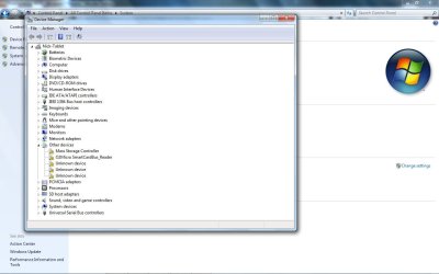

Here it is. Two of the unknown devices are related to my smartCard port, the other three I'm almost 100% certain are the TPM chip also on the motherboard that I have not installed the drivers for. I've tried linking each of those three with the Bluetooth driver just in case one of them was the hardware, but it didn't work at all.
Compatibility mode didn't help at all. Is the picture too large?

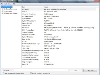

Ok please type into the Start / Search SYS and click on System Information
at the top op the Menu, Post a picture of the first page please. I know what machine you
have, I just want to see something.

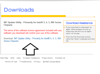

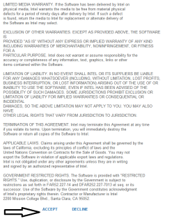

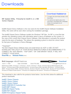

Ok just install the Intel chipset drivers please.
